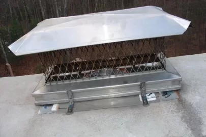

Good move getting up there. You could try a larger mesh screen. What kind of chimney cap do you have? I am using a very large cap with an open mesh screen. I take it off once a year and clean it with a brush and have had minimal build up.

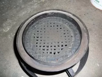

Here's a pic of the cap and screen. I would eventually like to find another type of cap that has a screen. My wife freaks out when a bird gets trapped in the stove. I'm 1 for 3 on getting them out alive. The rest of the chimney looked pretty clean, although there was a fire going, so I need to look again when there is not. If necessary, I'll sweep it again. Removing the screen made an instant difference, so I don't think the wood is the issue. The oak was split two summers ago and has been stacked and covered across the top since spring. Once the screen was removed, the oak took off like nobody's business. Thanks for the assistance.

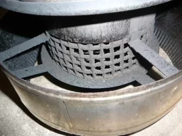

A pic of the side.

That cap seems to have a very small flow area, with the sreens installed, even when they were clean.
That does not look like creosote. Its just the fly ash and well burnt smoke particles that even my Catalytic stove emits. PINEBURNER is right, the cap seems to have a really small surface area, and the solid metal ring around it prevents scouring action from the wind which would have removed that light fluffy stuff. My screen looks exactly like CYCLOXER's and it works great.
I'll have to look for another cap. This one has worked great until I installed the screen this year.
I would use a coarser screen and put it on the outer circumference of the cap, not the smaller inside diameter and certainly not across the top of the flue.
