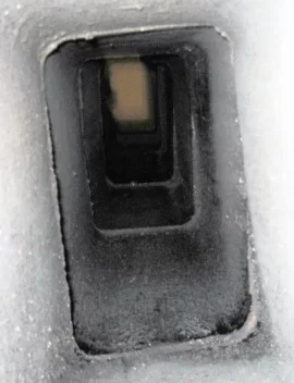

It was inspected and cleaned three years ago. We only burn one or two face cords a year. Took a picture up the flue and nothing looks broken. Should take a look from the top but it is feezing cold, icy and dark on the roof when I get home from work.

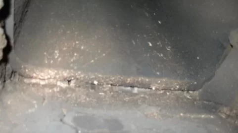

Second picture I am a bit concerned about missing mortar at the bottom of the tile lining, any comments.

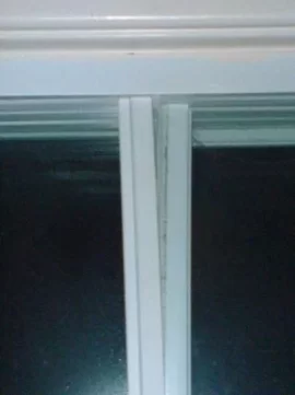

How important is the stack effect with the fireplace on the main level of a bungalow? Most rooms have a single ceiling light which isn't sealed in the attic. The windows do leak at the top as shown in the picture. The white trims should be straight and interlock making a good seal, they curve outward and don't. I have tried pushing them back straight but as soon as the window is opened and closed they are curved again. They are stuck in the middle so completely removing to straighten isn't an option. I could try painters tape on them and see if helps but won't be able to keep the tape up for long.
Wood quality isn't great but dry indoor air and loose stacking in a semi finished area of the basement has helped allot. Can't really do anything about stack size for the fireplace but Canadian code calls for full lining for the insert.
