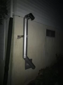

[Hearth.com] Smoke out of vent pipe at startup. [Hearth.com] Smoke out of vent pipe at startup. Just had new castle serenity stove installed yesterday. Looks good overall. In playing around a bit with it, I noticed a slight smoke smell when I start it up from after its been off. I turned light off and shined flashlight on exhaust pipe in back of stove. Saw some wispy smoke around pipe, which disappeared once pellets ignited. I just emailed the installer putting in this inquiry. FWIW, this is a basement install in a walk out basement. What do you all think?

There are pictures on this site of many folks also using a high temp tape at all piping connections. In your pictures, I do not see anything that looks suspect. Once you start the stove and the chimney gets warm, it will actually draw smoke up and out. So likely just the seal where the chimney pipe meets the stove needs to re sealed. IMO.

Most piping requires high temperature silicone connecting the stove adapter to the exhaust flue of the stove. Was there a reason for the 45’s outside?
I believe it was to gain further clearance from window.
