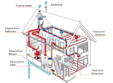

Where is the fresh air intake for the HRV system?
Can you completely turn the HRV system off a hour before lighting the next wood batch? Look at the diagram below and use your imagination. Worth a shot for a easy test.

Where is the HRV fresh air intake compared to the chimney termination? If its anywhere remotely close to the chimney can you bag it/seal it for a test.
