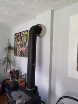

My new wood stove (main floor) is connected to a terracotta lined chimney which goes all the way to the basement, where an oil furnace (no longer functioning) is connected. to the same chimney. My chimney sweep put fiberglass in the chimney below the stove connection, and also where the stove flue enters the chimney. I worry about negative pressure from the basement but he tells me all is good.I had the ducts from the old furnace removed during a rehab of the basement. It's a 60+ year old house. I was thinking about covering the (now-useless) ducts, but I don't feel air moving when I have the stove running. Newbie also. Would appreciate your thoughts.
If you described it correctly, there are two big problems.
Two appliances on one flue is a big no-no.
Fiberglass is a big no-no.
I would suggest you get someone there with proper credentials. See https://www.csia.org/
The best way is to add a stainless (and insulated) liner into the terracotta connected to your stove. And to properly seal the basement flue connection.
Well first thing you need to do is eliminate the fiberglass in both locations. Install a good well sealed cleanout door at the bottom and install the pipe properly into the upstairs crock

Yikes! The old oil furnace in the basement is out of commission, so no fumes from her. She is disconnected from the outside and tank is gone. Only fiberglass below the stove connection. Fiberglass is a big no-no? That's a concern. I am out in the middle of nowhere, this chimney guy is well-regarded, fluent in local, but his relaxation does concern me ( but I am a nervous nelly). Hard to find credentialed folks here. They don't want to do the 100+ mile drive. Pic is the flue from stove into the terracotta chimney. Problems with the stove already. Now I have to worry about the chimney?
Fiberglass around the pipe is a problem as well and honestly pretty pointless it won't air seal well at all
