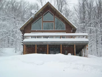

    OK, so I've been living with this for years and I'm tired of it. More importantly though, my wife is REALLY tired of it.
    We have a chalet-style log cabin, 11/12 pitch roof that holdds alot of snow and ice. On the south side of the house is the main entrance and the large front deck wraps around from the front to the south side and you step doen off the deck near the main doors. The attached pic is what I have and it shows the basic layout ok. The side deck is about 6 feet from the house to the railing.
    I get alot of icicles on the eaves and alot of dripping on the deck which of course turns to ice rapidly...eventually we get several inches of ice built up and the only thing I can do is stop using that door and have everyone enter/exit through the basement.
    The ideal solution would be to make the side deck into a porch and just let the ice go off the side into the lawn...but I can't do that midwinter and even in the spring thats probably not going to be in the budget.
    My wife wants me to put up a gutter...while thois would certainly keep the roof from dripping on us when it rains in the spring, I just can't see how its going to do a darn thing for ice...its just going to fill up with ice itself and just extend the icicle buildup out a few inches, right?

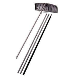

    I have a snow rake and I can get about 2/3 of the way to the peak of the roof mostly clear with it, and by using it is the only thing keeping the ice thickness DOWN to a few inches...in past years when I didn't clear the roof we were dealing with more like a foot or more of ice buildup right in front of the door.
    So, anyone have any ideas? I put some plastic down on the deck last night and it worked like a charm to keep the ice off the deck, but its ot a really workable solution since we cna't walk on it safely and there is no way my wife is going to be picking it up and putting it back down.

    How much insulation is in the ceiling? If not very much, or there is a way for warm air to get to the roof decking, that might be leading to more snow melt than you would have otherwise.
    If the roof gets lots of sun, you will have snow melt even on a roof of an unheated building, so there's always going to be water dripping down the roof if you get a lot of sun.
    I agree the gutter wouldn't help much. Instead of having to keep the walkway clear of ice, you'll now have to keep the gutter free of ice. Gutters are nice for when it rains, though.
    Is the ice a daily problem? That would seem excessive from just normal freeze/thaw cycles in the daily temps.

    The roof has about 12-14" of rolled insulation...not sure of the r-factor. Trusses are 2x14's 16 on center IIRC. Its a very thick roof. The main entry doors are not well insulated and despite my best efforts over the years are still drafty...but very expensive to replace as its a double door set...no storm door option either. That side of the house is southern and a touch western exposure, so it gets alot of direct sun. Additionally the woodstove chimney is right about in line with the main doors, up near the peak, which probably adds a bit of energy to the mix. The icicles are definitely longer over the door, but I've got big icicles all the way across that side of the house and only a few on the north side of the house, so I think alot of it has to be solar melting.
    I'd say yes, this is a daily issue in that I really need to shovel, scrape, salt and sand daily in order to keep it usable and safe. If I let it go a few days its game over until we have a thaw.
    Maybe I need those strips of metal up there to push the ice off to the sides? I dunno, but its driving me nuts.

    I'll take some pics tonight when I get home. I knocked the icicles off the edge yesterday afternoon around 4pm when I shoveled off that section of the deck and laid down my tarp to try and keep some ice from sticking to the deck. This morning I went out to lift the tarp so my wife doesn't kill herself slipping on it and I was shocked to find 18-24" icicles all along the section i cleared off. Now to be fair we got over 24" of snow yesterday and the roof looks like its got a good foot on there, I think there's just enough heat up there to keep the surface at like 33-40 degrees and keep the snow melting. Since the roof was totally covered in white snow, logically this has to be coming from the structure, right?
    I prefer to use the whole deck, so this sort of problem extends for another 10-12 feet, I'd say I have about 20 or so feet of side deck (and stairs) that are affected by ice on the drip edge. The front section gets zero ice from the roof because it just doesn't slope that way. We grill all winter long and sometimes I like to just go out there and enjoy the view on a warmer winter's day.
    Triple wall chimney pokes through about a foot this side of the ridge, more or less in line with the doorway. Master bedroom has 2 18x36" skylights, both of those are further towards the back of the house from the doorway though. There are no other protrusions on this side of the roof, bathrooms are both on the north side of the house.
    Walls are solid log, interior ceiling in the great room (front 3/5 of the whole internal volume of the house) is tongue and groove, so certainly lots of potential for air leaks into the insulated area there, I do not know if a vapor/air barrier was put up above the tongue and groove ceiling, but I took hundred of photos during construction so I'll have to dig them out and see, maybe I caught that part of the process. The ceiling in this room if a 26 foot peak ceiling and I remember a couple years ago I checked the surface temps with an IR thermometer and it can get up to around 100 degrees at the top of that room, can be a 30 degree difference when the stove has been cranking for a long time. I have definitely not sealed up interior wall receptacles and outlets, but I did do the exterior walls because they were all cold to the touch.
    The main doorway definitely radiates heat out of the house and could very well be the biggest aprt of the snowmelt issue as that section of the roof clears off well in advance of the rest...you can watch the semicircle form above the doorway over a few days time. Part of the latch mechanism for the second door was lost right after construction and that door has always been a bit loose, the primary door also never sealed quite right. I add weatherstripping and other cob job bit and pieces to try and seal it up better, but that one spot I woudl say is probably my home's single biggest heat loser. I'd love to replace it with a nice single door and two sidelights with a good storm door, but its just never been in the cards. Its an insulated fiberglass door and just touching the interior surface of the door I can feel the cold right through it...by comparison, those colossal windows on the front of the house are room air temperature on the inside of the house. I hate that darn doorway, but I just dont have the funding to replace it. Maybe the door is the core of the problem.

    Woa! Believe it or not, my next question was going to be: "Have you checked the ceiling's surface temp? Because it might be as high as 85 degrees..."
    But 100F? That changes everything.
    Even with R30 insulation, at a temp difference of 80 degrees (assuming ceiling of 100F and outside of 20F), the amount of heat lost through the roof is probably plenty high to continuously melt the snow, except on the coldest days of the year.
    I assume you need to run the heat to make the rooms with the large windows feel warmer?
    What is the average room temp in the main rooms of the house? Are they comfortable at that temp?
    I doubt the leaky doors are the cause of the faster snow melt on the roof at that place. The heat going outside gets dissipated quickly to the air and would not settle on the roof. But doors are often where there are air leaks into the walls/ceiling, so I'd start looking there, for a way that room air is getting into the ceiling.
