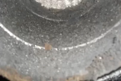

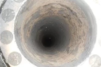

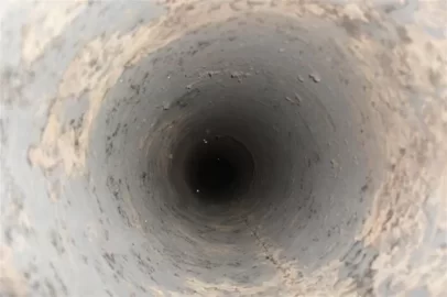

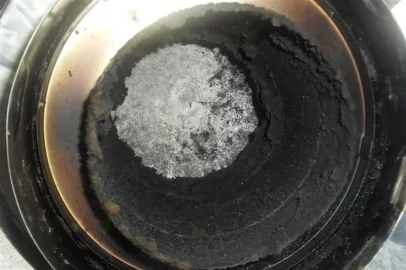

So it's been 2 years since I cleaned my chimney pipe, and this is what I found today.
tlhfirelion
Feeling the Heat
Aug 6, 2007
452
I started heating with wood 2 years ago, and I have triple wall pipe, 15' chimney, one elbow above my "lowes special" stove that hits a "T" and goes up and out. I have had mostly seasoned wood, but I'd say about 15% has been green/punky/paper/cardboard pieces, etc. Needless to say I was pleasantly surprised when I saw basically no buildup except for the cap that I removed for the inspection. At least I think I should be pleasantly surprised, I'm posting to find out if I'm right. :)
What little spotty buildup came right off with a wire brush from my shop. Tomorrow I will remove the bottom of the "T" and see how that looks but I'm thinking it will be ok.
What do the vets on here think? Am I looking good?
Thanks and have a good evening.

Looking great. Welcome to the dry wood burners club. Keep up the good burning.
Looks like you're doing it right. Personally, I check annually even though I know I won't find much. 2 years would be longer than I'd want to go without at least peeking in there.

I would have thought that the chimney fire would have cleaned out the cap too. :lol:
Just kidding. Looks great. I one pass brushed my 21 foot liner today and had a little more accumulation than that. A half quart. I suspect you are going to find a good bit in the bottom. If I leave mine until late like I did this year the cap is always spotless and there is a small pile on the baffle from the crap falling down over the dry summer.

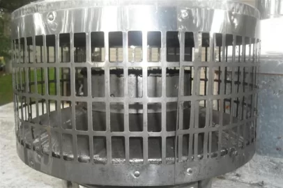

Hey Firelion and whoever else has some input on this,
The cap that firelion has- is that the best chimney cap to have. Is it significantly better than most chimney caps? Does it make a big difference in draft?
Looks good. I only hope that new guys won't take it that they only have to clean their chimneys every other year though. New wood burners should check their chimney monthly the first year and maybe the second year too until they know what they have inside that tube.

All that black crud on your cap is what my whole chimney looked like for most of last year after my stove warped and the cat broke. Even when the cat was working it would get 1/4" on the sides a month. Every time I see how clean the chimneys connected to an EPA stove are it amazes me.
