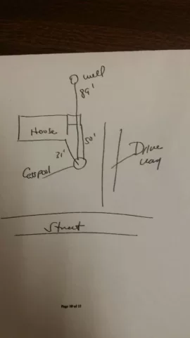

This is the only info from the town hall. Now I'm more scared- what a long pipeline. Why is it connected to the cess pool? Well info for dummies...

I don't think that sketch means it's actually physically connected to the cesspool - looks more like a tie-line for the distance that's written beside it. I.e. it's 89' from one to the other along that theoretical line. +/-, like. That sketch should get you in the ballpark by first staking out the cesspool location using the first 2 distances from house/deck corners, then taping out the 89' from there under the deck to out back. Not quite how I'd have drawn it, but better than nothing likely.

I took a real quick look at it over lunch, and yes the pipe looks galvanized rather than copper. And maple1 you are correct, those are the two permanent reference points, I didn't read the top of the paper.

Looks like the distance is roughly 49' from the back corner of the house +/- where it is measured 50' from on the square structure. Is that the septic tank or ?

I have to look at that line one more time to confirm what the inlet is made of. Pool is full. Got to get the metal detector. I do pretty much know where the old cess pool is-it's now filled with gravel.

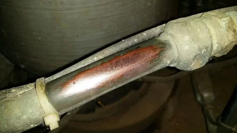

Line looks like copper to me. And very heavy gauge pipe. Scraped the pipe, steel wool, Brasso.

Never hurts to know your system but it is good to hear that pump was installed in 2007. Still have a bit of time to figure it all out. Interesting that your in-line is copper though - would have thought they would use pvc pipe as zero corrosion issues.

Distance to intake is interesting ... 140 (148?). Sounds like a 100' drilled well if you figure 50+/- from the house. Been out with the metal detector yet?
Gotta get to RI and get the metal detector from the parents. At least I'm narrowing things down, and I'm kinda happy about the copper line (as opposed to galvanized, wish it was a pvc line). I'm going to call the well company to see if they have any sketches or anything else useful. Then I'll spend a day(or hopefully 30 minutes) trying to find it.
