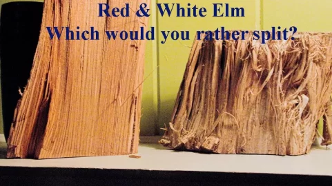

If it was just dropped and bucked, most of it will be too wet for this year, except maybe some smaller upper branches. It's middle-of-the-road between shoulder season and dead-of-winter fuel. If the wood is pale / whitish it will probably be a nightmare to split. If the wood is reddish, it may split fairly easily.

Its not bad heat.Can be a real bear to split (most of the time) because of coarse interlocked grain.Trees grown in the open are usually the worst offenders,though forest grown can be tough sometimes too.If standing dead,look for little or no bark left,long vertical cracks & silver-grey or brown color.That will mean its had a few years to dry on the stump,makes for easier splitting. Slippery/Red Elm is much easier,though its fairly stringy also.Much better heat because of higher density too...

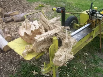

Jon1270's picture is worth 10000 posts;)

Chances are, it is not ready to burn. It might be possible for the top third of the tree to be dry enough but no more than that. Elm can be a good wood to burn but that also is dependent upon how it is split. If it can be burned in the round, so much the better. If it has to be split, then it depends upon how it looks after splitting. If it comes our all stringy like a couple pictures above, then it is poor firewood because it will burn like kindling wood. If it splits nice and not stringy, it is good firewood.
