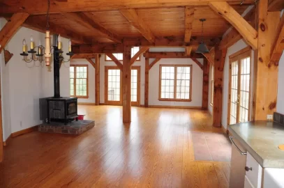

I built a concrete heat shield for my Mansfield. I embedded a copper serpentine pipe in it to run hydronic water through it to assist my radiant heat. My guess is the new owners didn't guess what I was up to and trashed the whole thing.
