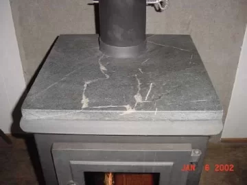

here is a panel added to the top of an englander
  • [Hearth.com] Soapstone Along w/ Firebrick??
Any added benefits to the slab on Englander??

I'm not an engineer but I don't see the advantage of adding soapstone to a firebrick lined firebox. First, I believe each firebox is designed to maximize combustion heat for clean burns. Stoves designed with firebrick I would think would be set up in such a way to maximize the properties of firebrick in the combustion chamber. Tampering with that probably would reduce your stoves efficiency. Secondly, soapstones main attribute is its ability to absorb large quantities of heat and therefore remain warm for a long time, moderating the relatively radical heat and cool spikes of wood combustion. I would think it would be more effective added as a stove top as Gunner did so you could take advantage of that attribute while not risking decreasing firebox efficiency.
A big chunk placed on the stove top isn't that much different than a big kettle full of water. They both create a relatively cold spot on the stove. How can it hurt? I would stick it on the outside as a slab and preserve the inner firebox environment for the sake of fuel load and efficiency.
