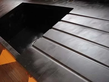

After seeing what I did to that 120+ year old sink when I have the money to throw at a new counter I am going full speed ahead with soapstone. The built in dish-drain is BRILLIANT!
