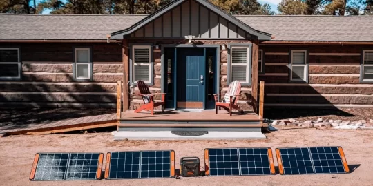

A couple manufacturers have battery powered inverter backup power units now. This one by jackery is interesting with a 1800w continuous and 3600 peak sine wave output. You can use solar panels, grid power or your car to recharge it. Looks like a great little unit to keep the fridge running and some lights and electronics on. The fact you can just bring it inside is nice. I have a Harbor Freight inverter gas generator but this unit would be great for plugging in the fridge over night. My fridge only uses 70 watts running. I did some math and this unit would keep my fridge going for a really long time with its 1500/wh capacity.

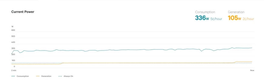

Depends on the model, I have an LG fridge with an inverter driven linear compressor, it pulls 100 watts when running, but it runs a lot longer than most fridges. Mine only hits the peak amperage when the heating elements kick on inside the fridge for the defrost cycle.
Here's my current house consumption, this is my fridge compressor running, a 65" QLED tv on, my laptop on, and the blower for my stove running:

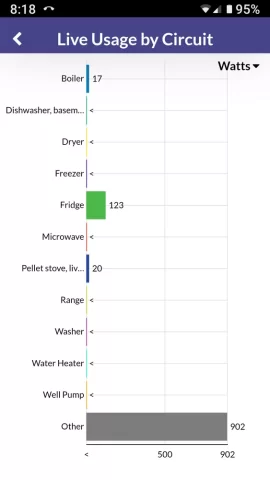

At the risk of contributing to thread drift, I just wanted to add a screenshot from my Curb energy monitor to help illustrate the relatively low consumption of a fridge. I was always under the impression too that a fridge used 650-750W until I got the energy monitor with individual circuit level monitoring. Mine uses 120-140W running. It is not a new, super efficient one. It's a Fisher and Paykel from the early 2000s that was in the house when we bought it, so I'm sure newer models use even less energy.
