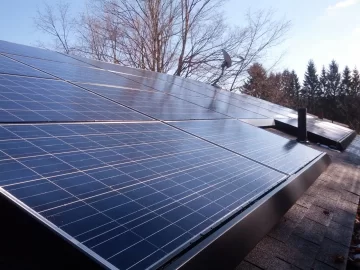

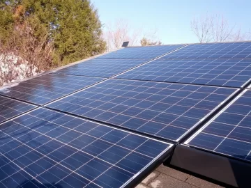

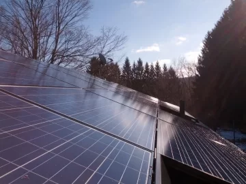

Here are some shots of my back roof. I have 33 panels on the back and 55 panels total.
