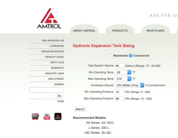

Go to Amtrol.com and use the free calculator to size the tank, most times those Aquatherms have undersized, or grossly undersized expansion capacity.
Here is an example using 65 gallons of total system capacity, 50- 210° operating temperature, 15 psi fill pressure.

I just did a search for the Amtrol tanks you showed from their calc........man... they're expensive! I can see what you mean by mine being undersized! Unfortunately, that's where I have to usually make my things work, or go outside the box to use/adapt something for me.
