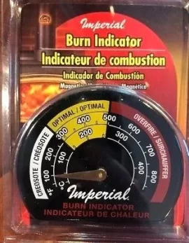

I picked up the Imperial Burn Indicator, and it reports exactly the same numbers as my IR gun. They sell it up here at Canadian Tire and Home Depot. Can't believe I used to have a fire without one. Realized quickly that I was burning much too cool.

The ranges are for stove pipe temps, not stove top. It can still be used on the stove top but ignore the ranges in that case.

I just bought an Imperial like pictured to see if it is any more accurate than the "free" one the dealer gave me. The free one is a good 125 off as said. You can calibrate a magnetic by hitting the pipe with an IR at 18 inches and just move the magnetic down until it reads the same as the IR at 18". I am puzzled how the one pictured is reading 100 dgrees in the packaging?

It was a hot day

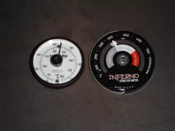

I've done a lot of back-and-forth with these two and found the Condar to be pretty good.
[Hearth.com] Some bi-metal stove thermometers are crap!
Inferno stove top thermometer and the Condar Fluegard seem to work well for me. I don't have an IR gun though so not too sure how accurate they really are, but the stove runs just fine when they are both in their optimal zones.
