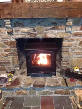

Nc 30 would be a good choice I'm currently trying to talk a friend into the same setup . They get good reviews here
Reactions: WriteNoob
My stoves can rear-vent, so they sit out on the hearth with the back of the stove about even with the fireplace opening. Plenty of radiation to the side of the stove where we generally sit.
Only difficulty is the 30 is top vent, Some dinking around is in order to have it siting partly out and still connect to flue. The top flue vent is close to a- 3" stub above the top of the stove.
