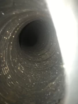

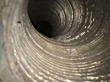

Before sooteater.....and after sooteater. Amazing little tool. Did it from the bottom up. Hardly no mess with the draft pulling everything up the chimney.
  • [Hearth.com] Sooteater

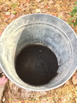

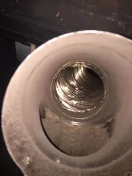

Just finished cleaning my 21 ft liner with one. Was wayyyy dirtier than I was hoping. A little more than a gallon of mostly black soot and glossy flakes.
The dents in the liner was to squeeze through a flue plate.
I’ll admit I was burning with sub prime red oak last yr (financial reasons) mixed with dry maple.
This year should be much cleaner. Burning 10 month stacked ash, 2 yr red oak and 2 yr maple/elm for shoulder seasons.
Top down cleaning yield:
[Hearth.com] Sooteater [Hearth.com] Sooteater
