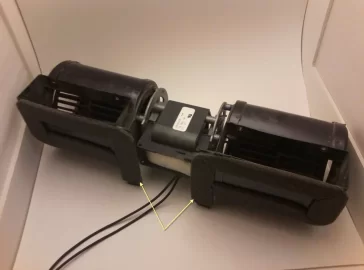

I noticed the new St Croix blower does not have the foam glued to the bottom for shock absorption.
1/2" Flat rope gasket with high temp RTV works just as good.
Any motor companies have an equiv to this?
J238-200-2040
115v 60Hz 1.6a
E64080 E48562 LR20432
See pic below of foam on bottom. Click pic to enlarge.
  • [Hearth.com] Sourcing a St Croix Convection Blower - any cross refs?

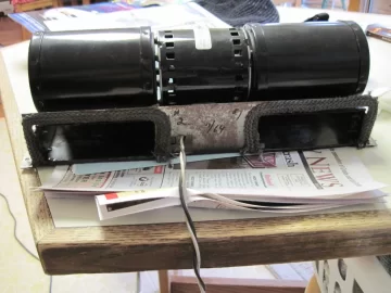

That motor doesn't look anything line mine. Mine has an enclosed motor, typical cylindrical housing. The fans look the same. Here is mine:

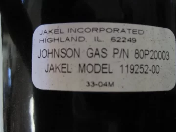

Interesting! That is the original motor I pulled out of a 4 year old stove purchased in Hookset NH !
Which one - the one in my photo, or yours?
I'm thinking that my stove has had both combustion and convection motors replaced in the past. I did buy it used. The combustion blower doesn't look like others I've seen in pictures. I'd like to get a look at a new stove to see what the original motors really are.
My pic is the original and the st. croix replacement looks just like it!
See
(broken link removed)
Mine is definitely a sub, as is the combustion motor. Mine has no rubber isolation mounts, and the noise does get transferred to the floor and through the house. The floor makes a great sounding board.
