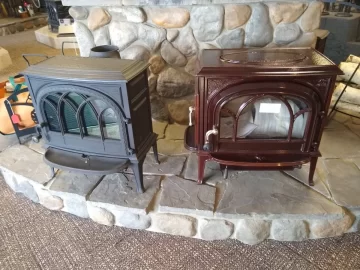

I was able to stop into a showroom today and see a 400 next to a 500, and talk to the folks there. Here's some of what I learned from them. The new EPA standards call for lower emission rates, and while the 400 is not compliant, versions of the 500 other than the V3 are also not compliant. The 500 that they had on the floor was the older non-catalytic version. He showed me a video that the Jotul folks put out where they talk about adding the combustor to the V3, and how the combustor has a 20 year warranty/expected life. The video also talked about how it also doesn't require any bypass during starting, which meets our needs for easy operation and also reduces the smoke during the start which is a nice bonus. Oddly, there seems to be no price difference currently between the 500 V2 and V3. His price for a new 500 V3 in matte black was $3009 which seems about right. The V2 enamel one in the picture was "on sale" for 3239. He said that there is a discount of $875 on the 400, but said that a price of $2600 was after the discount. I think he was mistaken about that, since it seems like $2600 is closer to full MSRP on the 400. But if we can get a 400 for $1500, that's quite a bit less than $3000 for a 500, v3 or otherwise.
So one big question is whether we capitalize on the up-front savings and get a non-compliant stove like the discounted 400, or whether we spring for something like the 500 v3 to get better efficiency and more value over the long term, by burning less wood. And putting out less emissions is nice too. Just looking at published burn time numbers, whatever they are worth, our current F3 is 7 hours, the 400 is 8 hours, the old Oslo is 9, and the V3 is 12. If these are a proxy for efficiency, that's a big difference between the new and old Oslo. There's also the possibility that the 500 is too big for the space. So I guess I shouldn't be asking if the 400 is big enough, but rather is the 500 too big?
The Model 45 V2 is an option if we want compliant emissions but smaller size. That and the 602 v2 are the only other stoves currently compliant and offered by Jotul. I wonder if they will expand that line in the coming years or what.
