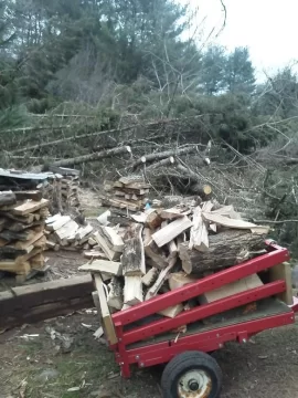

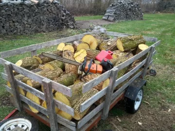

[Hearth.com] Splitter build DOT platform I have the HF 4x8 folder trailer and have thoroughly abused it. I has held up pretty well hauling double the rated capacity at low speed behind my quad. I bent the frame slightly when setting a big chunk of concrete (probably 700ish lbs) on with with the excavator and the chain slipped (whoops)...I don't think you will have trouble with firewood.
Here's about 1/3 cord of green-ish hedge...and I've had a lot more than that on there before. That's probably about 1700 lbs, give or take. It made the quad groan a little.

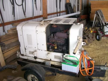

Also keep in mind that altering a trailer is a pretty easy proposition in most cases. An old boat trailer or a single place snow machine trailer can be modified pretty quickly to match your needs.
Notice the trailer that the genny is sitting on. That USED to be a single place snowmobile trailer...title and all.
