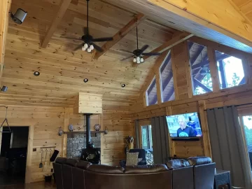

I have a similar setup my vaulted ceiling room with my stove is 24x28 with ~18' ceiling with R30 in Maine. The Vermont Castings Encore ~2 cu ft firebox did a very good job of heating this room, and the loft upstairs. My bedrooms at the end of the hallway did not get very warm with just the stove, due to the layout of the house. I have a huge ceiling fan in the room too, but didn't seem to make much of a difference. You will need a door at the top of the stairs to the loft, without it will be too warm to sleep up there.
I ended up selling the VC Encore just recently and got a Blazeking Ashford 30. If your just burning here and there and not really using it for primary heat a smaller stove will likely be fine, but burning wood is kind of addicting and i bet you will use it more than you think.

That's a large house, that will need a large stove. The stove location is like mine, in the corner. It provides a great view of the fire from any place in the room. The hearth has a large foot print and corner location is a good place, as typically it's not being used. Stoves have intense heat in one location. So the great room works well at giving the heat a place to go, heating up the structure. Your loft will never have any heat turned on. The ceiling fan helps with mixing the air up within the great room. I have very even heat throughout my great room. The back bedrooms will be cooler. Mine are about 5 degrees cooler. Being a new house, get the best insulation windows possible. It really helps with a wood stove at one end of the house and rooms with outside walls at the other end of the house. There is a natural air flow to my back rooms as the stove fills the great room with heat. The heat will flow high in hallway to the rooms as cold air runs along the floor back to the stove room. This is always a issue, you can't put air into a room without taking air out.

Yes, to OP. Just my thoughts with my house that's very similar. I now read the house is done. My loft bedroom is open with a half wall. I really makes the heating easy. With my setup -10 F is no problem heating all the house. And I like to control the temp swing as well as a thermostat. Night's are a lot of work. After 23 years we are getting lazy about running the stove all night.
Yeah. The house is done. Would have done a lot of things differently but we're beyond that at this point.
We also have a half wall for the loft. What stove do you have?
My stove is a Jotul Oslo Version 1. It's a non cat, cast iron. It's the dark green vittorio's enamel finish. 23 year's old and it gloss finish looks like new, not a mark on it. Well worth the few bucks. Our stove and fire is the focal point in the room. The latest Oslo 3 has a cat. You will love the stove, even if you just run it for an evening fire.
Curious, the house looked great, what would you do different?
I'm glad to hear your jotul enamel finish still looks good after all that time. We have a Jotul Oslo V2 in the majloica brown enamel that's 5 1/2 years old. Really love this stove. It is a focal point in our great room. I love the enamel finish. We have a very open floor plan with high ceilings. We don't use the stove exclusively to heat but that stove can crank out some good heat once it gets going. The room which stays colder on this floor is the room behind the stove which is the master bedroom. We are actually glad it stays colder because we like to sleep in a very cold room.
