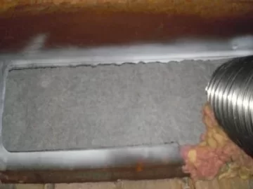

I installed the Flex King Pro liner kit attached to a Lopi Freedom insert. Went fairly easy . . . but still took a couple of hours. First, to construct a block plate I laid a piece of card board over the existing damper opening (with obstructions already cut away), and spray painted the border so that it could be traced onto a scrap piece of concrete tile backer board. Then I cut out the backer board to fit the opening and removed enough material to allow the pipe to fit snuggly through the block plate. With the block plate in place it was insulation time. There were two small gaps between the block plate and back of the pipe, so I stuffed maybe 3 handfuls of fiberglass insulation to keep the rest of the insulation from falling out of the chimney before it had a chance to cure. I went with a 3 part Perlite, 3 part Vermiculite & 1 part Portland Cement mixture, wet it enough to be damp but still loose and poured it down the chimney around the liner. I used the cement mixture until I had used the complete 47 lb. bag of cement, which covered the entire block plate, about 1' of liner pipe & filled most of the smoke chamber. For the rest of the chimney I poured a 50/50 mix of loose Perlite and Vermiculite while holding the liner as centered as I could. Once full, all that was left was some silicone sealer and a few self tapping screws. It took me about 6 cubic feet of both Perlite and Vermiculite and one 47# bag of Portland Cement. I used about $65 worth of materials and had about $20 worth of Perlite and Vermiculite left over . . . so a total cost of $85 to insulate.
