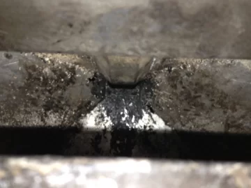

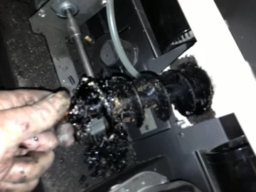

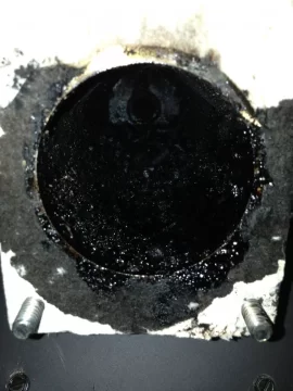

It is covered with what looks like oil! See 1st pic below. Black burnt pellets with oily goo!
The hopper, and auger and fire box is covered with it! It was even dripping down to the floor in the front! Eeewww!

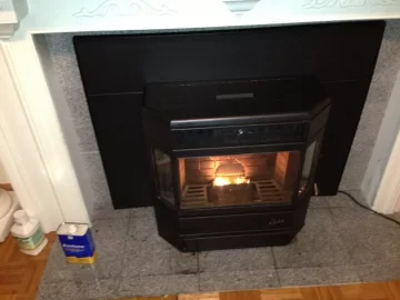

To do the stove cleaning I sent out for a can of Acetone!
Like the comercial says. This gives stove cleaning a new meaning! Jeezzz!
This is a 2009 St. Croix Ashby-P insert purchase 2 months ago and only used 2 months!

Has anyone seen such oily goo in the hopper and around the auger? ? ? See pics below!

Click pic to enlarge - Finally after 10 hours of cleaning it is up and running!

Wow! Those pictures make the unbelievable - believable. What a mess. Gotta wonder what the flame looked like. How much acetone did you use? I think I can smell it from here!
That looks like a poor burning wood stove holy smokes!

I used a quarter of the can of acetone which worked really good. So it looks better. The hopper lid switch went up in smoke! LOL

I recently cleaned up a EF3 that had the goo all over the heat exchanger tubes. The stove's internal baffles were completely clogged with ash, impeding good combustion/exhaust air flow.
