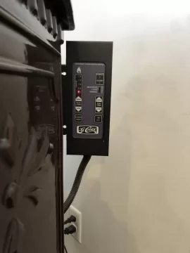

Here it is now, on Level 1. Flame big and all over the place. Inside you can see the buildup of pellets already. Been this way for an hour

I have a Hastings and I can tell immediately from your pictures that you don’t have nearly enough air moving through the stove. that flame is not good at all. The Hastings is a great stove, a real workhorse in my house, but it like any other stove has to be maintained properly.
With a flame as poor as the one in your picture it doesn’t surprise me that it is throwing a #3 code which means the stove has either timed out waiting for proof of fire during lighting or the heat from the flame is so reduced that the POF switch has flipped back to “undertemp”.
I would strongly suggest you stop throwing things at it and concentrate on the real problem which is airflow. There are only a few things that can affect this, intake, restrictions through the air path, and exhaust. You said you replaced the chimney? If you’re SURE that’s good now, all that’s left is the exhaust or “combustion “ blower and the air paths.
Considering what you’ve done already, I would go straight to the combustion blower. If you haven’t physically removed the combustion blower and cleaned out in there, then that is definitely a place that should be checked. When looking at the stove from the front its located at the left rear corner. Remove the 6 small nuts holding it and it lifts right out. If You haven’t been in there already, I’m betting the housing underneath is clogged and or the blower itself is clogged or failing.

Also make SURE the Ash Shaker Rod is pushed back IN all the way. This is the rod directly above the ash pan door. if this isn’t pushed back in all the way then the air flow can go around the burn pot and you get a terrible flame.
