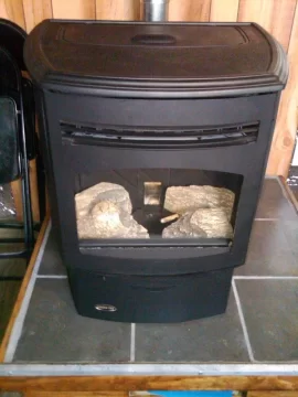

    Your welcome. I have a Quadrafire Santa Fe in my shed with a switch in the house that switches the T-Stat on. Works great, when I go out there after breakfast it is a comfy 70 Deg F.
    Click on pic to enlarge.
