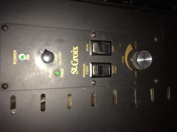

I just got home and started up my st croix pepin pellet stove- that has been running great since I got it
Went back out in the garage and saw that it had shut off- don't know why
So I restarted it and watched - it ran for about 5 minutes and all of a sudden the auger just quits dropping pellets down- it will work if you hit the manual button for pellet drop
I swept it out thinking that was the problem and it did the same thing again
Does anyone have any Idea what my problem could be with this stove ??
Any help is appreciated !!!!
And what led(s) was(were) blinking on the control panel)?
The main power light was on and the feed light stayed on I believe- only lights on this model

Ok so I just restarted it - it ran for exactly 10 minutes- it fed the pot and as I started to feel some good heat it shut it down and the fuel feed light has gone from blinking (it blinks when it feeds the lot) to just a solid light now- and feeding has stopped
Your way way overdue to clean it. I suspect and others will probably pile on to that the exhaust paths are full and poor fan can't expel enough gases to keep the vaccum switch pulled in.
