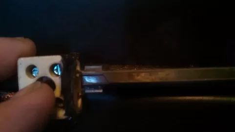

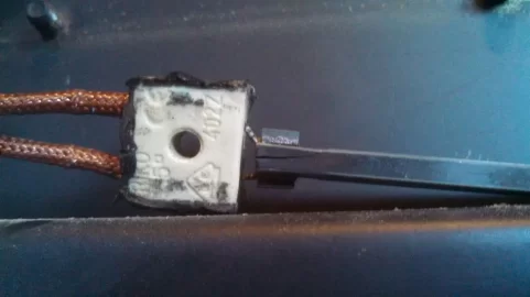

Looks like I found the problem. After a closer inspection, I found the igniter is cracked at the base where the wires come in. I am assuming it should not be cracked. Here is a pic [Hearth.com] St. Croix Revolution help. [Hearth.com] St. Croix Revolution help. [Hearth.com] St. Croix Revolution help.
If it's easy to get to, check for voltage getting to it during startup.
Check it for continuity with a meter. Or, connect to line voltage in your shop, on a heat resistant surface. It should get hot.
