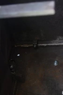

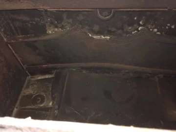

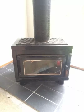

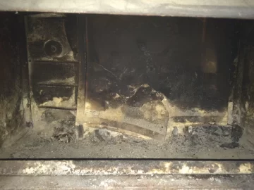

I recently moved into a house that has a Stack Vista 640 Woodburner which was installed sometime in the mid 80's. When lighting a fire it got a little smokey like nothing was going up the flue and then when I closed the door it kept killing the fire. It looks like the back baffle is cracked and crumbled a bit, and the upper baffle is worn and the middle part of it is warped upward. I attached a photo of it.

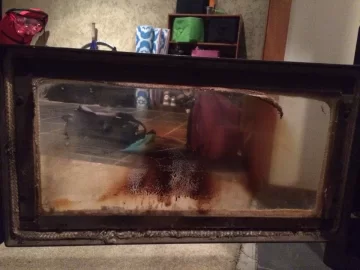

I've also attached a photo of the inside of the door as the rope insulation thing looks a little worse for wear.
The other thing is the high/low lever seems to have no tension anymore and just drops to the low setting.
Any advise or thoughts on what I may be able to do to get this fire working again would be great.

Time to buy a new stove there. The thing looks pretty worn out, some warped area's and a smoke dragon with a huge wood appetite
Agreed. A chimney cleaning, new stove and fully seasoned firewood will make for a much better experience.

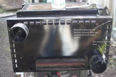

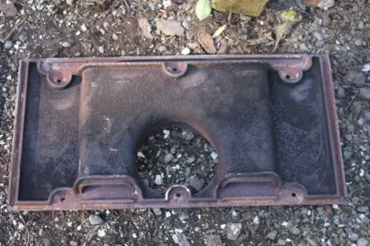

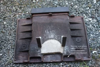

Here is one I converted to an IntensiFire. They are not a big stove, and the IntensiFire sort of splits it in two. Needs an adapter made to mate up to the IntensiFire.
One image shows where you start disassembly. You want to watch for another weakness, both those that have an IntensiFire had come away at the junction of the side plates to the bottom plate and I made a little bracket to hold it together. I also bolted the good part of the broken baffle under the cracked base. It is still working well two years down the track.

To be fair, if going the IntensiFire route you would see about picking up a more suitable candidate for a few hundred dollars on craigslist. Refurbishing this stove would be best done by stripping it down, so a half day job to do that and reassemble.Those broken baffles are not required, and just unbolt. I never worry about a door seal with the IntensiFire, a little extra air doesn't hurt, but probably a cheap part over there. It would give another 30 years of service without too much work, but it has to be a well considered project.
