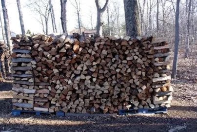

I stack on a row of 40"x48" pallets, with the width being 40". My splits vary in length from about 10" to 20". I put 2 rows of splits on a pallet which usually leaves room in the middle. To handle the shorties I either use them to fill the gap in the middle or I go with 3 of them across if they fit in the 40" width. I have had circumstance where I had a significant amount of shorties from huge rounds cut from the bottom of oak trees. I went 3 wide and cross stacked. If you look at this picture, on the left side there is a partial cross stack at the bottom next to the end. This goes 3 shorties across and cross stacked.
