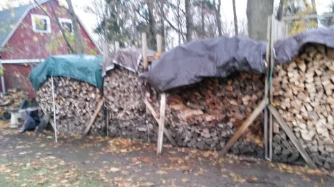

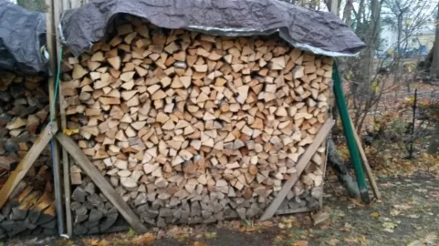

I have the same problem. I left a pile of fresh hickory and ash rounds on the ground in June and when I went to split them in September, termites had bored through several layers of large rounds already and the ground where they were sitting was bone dry on the surface. I know the OP mentioned cost as a factor in determining what to do here but I figure if you are able to do something right at the beginning, it usually saves a lot of cost and headache down the road. The first few years I was stacking wood on makeshift pallets and so forth before I finally built some racks which have eliminated most issues I had with insects, pests and stacks falling over.
Here's what I did:
1) Found someone giving away a truckload of those flat red patio blocks on Craigslist. I laid them down on the ground to form a support base under each rack that wouldn't sink into the dirt.
2) Bought cheap pressure treated 2x4s to make multiple 8'hx4'wx8'L racks with side posts to support about 2 cords vertically each.
3) Put it all together and placed on the patio block base which is then liberally hosed down with termite/bug killer every time I get ready to refill the stack.
This set up has kept the wood bone dry even at the bottom, no termites and less pests overall and I haven't had to re-stack anything that has fallen over like I did several times in the first few years. In the spring, whatever racks are empty I tip over, rake up the mess on the ground, reapply bug killer, turn the rack upright and refill with new splits. Maybe this might be helpful...
