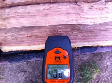

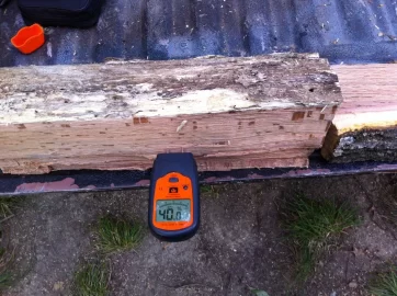

Here is an example of wood that is "seasoned" The first pic was standing dead for 5 years, the second had leaves on it when it was cut the same day.
  • [Hearth.com] starting to use my stove, new to cord wood heating
