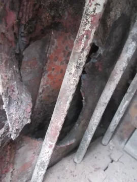

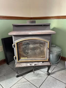

I think I'm in the same boat. Looking online this afternoon I saw this Quad. The sticker on the back states it was born in 2000 on the month of January but the top that shows the model is scratched beyond recognition.
Only issue with the stove is the metal baffle above the air tubes has a fist size hole blown in it. Looking online they are now $350. I'll have one made and look into this blanket that goes on top of it? Good thing the stove was free! It was up for an hour but I was the only one to get over to the seller. They said I was the 4th person to contact them and when I asked what happened they said the others just stopped communicating. He had taken the side panels off and couldn't figure out how to get that steel out. I presume the three baffles have to come out then the plate manages to come out? Here's a good explanation of the control's also in the video

Yes, it's nuts. Back in 2013 it sold for $180 and that was an ouch then. Have one fabricated at a heavy iron & steel shop out of 3/8" steel.
