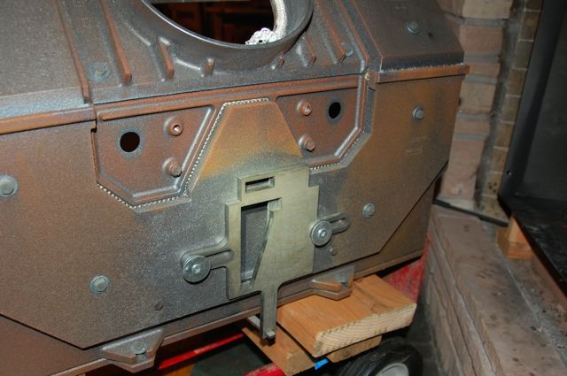

I have an update on this issue, and would like some advice about how to fix it. The dealer did not have any advice for me when I asked about it. They're generally helpful about getting me parts, but this one was beyond them. I tried contacting the Denmark office and the two U.S. importers, and got a response back from the eastern U.S. importer, who was helpful and encouraging.
To access the air intake, I had to take the cast iron firebox out of the outer shell. The intake valve is connected to the back of the firebox. To get it out I had to do the following:
1. remove the door (not technically required, but helpful)
2. remove the firebricks and baffle
3. remove the four bolts on the bottom plate
4. disconnect the flue collar
5. remove the four adjustment base bolts. These have feet welded on, so they have to go down through the bottom plate.
6. remove the front shell frame. There were 7 or 8 little bolts; their nuts are welded onto the frame.
7. slide the heavy firebox out of the shell (I slid it onto a hand truck with scrap wood shims to keep the stove level with the shell).
[Hearth.com] Sticky damper on Morso insert
So there it is, the "secondary draft control." It slides back and forth kind of okay (not great) when I push from the back, but when I had my wife try with the handle, I could see that it tilts, and that make it harder to slide. It has about an eighth of an inch vertical play which it seems like shouldn't be there. I could try tightening those two screws, but they have springs on them which I think are supposed to keep them at a specific tightness so I don't know if that will help. You can see in the picture where the graphite powder is. It seems to be protecting the iron from rust. Anyhow, I reckon I'll get some of that tomorrow and try applying more and see if that helps.
At any rate, here are my questions:
1. Does anyone have any suggestions beyond applying more graphite powder and trying to adjust the screws?
2. The flue collar gasket falls apart when I tug on it. Any tips for how to get the old gasket out quickly and easily?
Thanks.
I don't have a Morso, But I would pull the two bolt-screws off and separate the secondary draft plate, And polish it up with fine emery cloth-paper, And clean any grit out off the plate and the rear of the stove, I would also check the edge's of the plate or the slots in the where the it slide's on the bolt screws for a Burr that could cause it to stick or bind. I would hit all the edge's on the draft plate with a small file or fine emery to make it burr free, Check the pivot on the control rod under the stove and make sure it's not binding and lube it all up with {graphite} or {drislide} and reassemble and see how she works! The springs are on the screws bolt to keep pressure on the plate during heating and cooling off of the stove- expansion and contraction. I use drislide on my linkage it works well for me, I use it because thats just what I happen to have, http://www.drislide.com/products/drislide-bike-aid-moly-lubricant-w-needle . I think ya have a Burr hanging up, or grit between the plate and stove body. pecor
Reactions: Gazing in Wonder
Is that secondary or primary air that is being controlled? Looks more like primary air.
You are correct. The parts list incorrectly identified this as the secondary draft control, but reading the descriptive text, I see the parts list is wrong. Thanks for pointing this out. I prefer to know the right names for things.
I don't have a Morso, But I would pull the two bolt-screws off and separate the secondary draft plate, And polish it up with fine emery cloth-paper....
Thanks for the suggestions. I was nervous about taking things further apart, but this was pretty easy. I picked up some powdered graphite and emery paper at the hardware store (they didn't know what emery cloth was). With the control off, I checked the handle action (thanks for the reminder, I would have forgotten), and it was fine. There were some parts of the control with more texture than others, and one part that had worn grooves. I rubbed these smooth, hit all the edges to take any burrs off, lubricated the area, put it back together, lubricated more. Now it works like a charm. Better than new, actually. I'd still prefer something with a gauge, or some way to know where it's at before and after I adjust it.
Anyhow, thanks for all the help. Now I just have to put it all back together and hope it works. I guess I'm lucky I didn't have to drill out any rivets.
