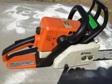

Cleaning our garage and I have a 4 year old Stihl 025 16" chain saw to sell. Was stuck in tree last year and when the tree fell it bent bar and pulled bar stud out. It still runs great but needs stud replaced. Its only been used to cut my firewood at my home. 75.00

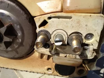

Anybody deal with this? The bar stud is pulled out 3/8" or so. I'm wondering if the stud seats in plastic that it stripped threads and you need to replace whole bar side of body?
You shouldnt need to replace that half of the saw... as long as the damage isnt severe there. You can try to re-tighten the stud (double nut the stud, turn it in, then use two wrenches to get the nuts off). Or, you can buy an oversized stud for that model saw if the hole is wallowed out some. Stihl Part # 1123 664 2405 (thats from a post over on AS)
