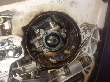

Mike, I agree with what stihlhead said, look closely at your crank seal. If it's toast your top end will soon look like your clutch.
The "shield" you pulled off should be the clutch drum itself. The "band" clamps on the drum NOT on the shoes.
Looking at the pic you posted, WOW, that did get hot didn't it.
Hope you get the rest of it apart and don't find any major issues with it.

Well, that is the bane about the orange handle plastic Stihl homeowner saws, they have plastic engine housings that can and do melt. Some melting of the case is OK, but more is not. I fixed one melted plastic case oil galley in a 250 with a straw and JB weld once, but I would not recommend doing that. I also fixed a broken fin on a 021 flywheel with super glue, and it is still working. I do not recommend that either, but it worked. The 028 is old school and more in line with a Stihl pro saw, in that it has a split metal engine lower case and thus is less prone to damage when doing things like smoking the clutch. They are built better, with better plastic (white) and they have more pro features. The top ends are easy to work on, but the oil pump and the areas where you are working on with the 029 are a different story.
With 2-stroke saws, use good gas and good premix oil and tune the carb right and you are 90% of the way to a long life with your saw. The #1 way to cook them is straight gassing them. I did manage to straight gas one of my 361s once, but I caught it right after I noticed the revs going up after refilling it with the gas, and lo... it was the lawn mower gas. I dumped the gas out and popped the spark plug and put in some premix oil and yanked on the starter rope a few times, and then filled it with mixed gas and re-started it. I pulled the muffler later and checked it, and there was no scoring. The pro saws will usually burn a full tank of straight gas or more before scoring badly, whereas the homeowner models will not.
The #2 way to score a saw is running it too lean and/or overheating them, and there are several ways to do that. Running them WOT all the time will overheat them, which is a common problem with chainsaw milling. Running them with the H screw set too lean will score them over time. Running them out of gas all the time will cause them to run lean at the end of the tank of gas. Also tuning them at a higher elevation and then running them at a lower elevation will cause them to run lean (I know people that have blown saw engines that way) . Similar issues come from tuning them with a long bar and then swapping to a shorter bar, which can cause them to over-rev at WOT. And of course if you open up the muffler, you need to richen up the saw, or you will smoke it in a hurry by running it super lean. The EPA has mandated that the carbs on all new saws be set with limiter tabs on them to prevent you from running them richer. As a result the new factory saws are usually set right at the point of running too lean. On any saw that I buy, I pull the limiters, cut the tabs and then reset the limiters back in place, and then tune them richer. The saws run better that way and are less prone to overheating and scoring. NOTE: if you remove a limiter tab and later have your saw worked on at a shop, they are required by law (EPA) to restore the saw to its original EPA condition, meaning they will replace a modified muffler with an original one, and/or replace any trimmed limiters with new limiter caps. They have to do that by law... just keep that in mind with any saw that you happen to modify. There is no law against you modifying the saw yourself though.
Then there is the running the saw with the brake set issue, which is about 3rd in the reasons that I see the homeowner saws being smoked. Those saws are commonly sold on Ebay, along with straight gassed saws. Crappy gas is a another common cause of engine failure. Low octane (old or bad) gas will cause flaring and uneven burning and uneven pressure on the piston, and that can cause scoring when the piston tilts a tad on the downstroke. Ethanol gas can cause problems, but usually only when it is exposed to water, and then the gas separates from the ethanol and water. Using pure gas, or E10 with a stabilizer (or premix oil with stabilizer in it) will help prevent that from happening. Using TCW marine premix oil will usually gunk up an air cooled 2-stroke engine, as will using cheap multi-use premix oil. Use a JASO certified premix oil, preferably FC or FD grade. Using too much oil can also gunk up the engine and cause more carbon to build up faster, but usually that is not an issue. I use about a 45:1 gas/oil mix ratio, as there is some evidence that slightly more oil will create a better ring seal, and thus more power in the saw.

In your picture I see a good bit of melted case below the clutch.
Rope in the cylinder and turning the clutch clockwise will work fine for removing the clutch. Forty bucks is a tight budget considering you need the entire clutch/drum/bearing setup.
If anything beyond that is damaged, I'd be looking for a parts saw or a replcement. Might be worth the time to get your local dealer/saw repair shop to look at that case and say wether it is good to go or not.
Well just went it out and took off the clutch..........fried! So what is the next step here? Tips?
Guess I will just hold off on this repair, not sure if it is worth spending the money on all the parts. I think I will just wait on a parts saw to come up like said above. I will just learn from this mistake since I have very little money invested in this saw and move on. On a lighter note, do all new saws have plastic cases like this one?
Well, the new lower end/homeowner saws tend to have plastic engines cases and housings, at least on Husky and Stihl saws. The more expensive pro saws tend to have magnesium lower engine cases. At least you have a good engine? You could buy a scored engine 290/310/390 and swap in your engine. I did that kind of swapping on several of my 025/250s. Or you could unload it on Ebay 'as is' and someone else could use the parts, or you could tear it down and sell it on Ebay as parts.

Generally not worth the $$ using new parts but there are plenty of nasty dirty old 029's, 039's, MS290/310/390's out there that would clean up good and take your engine no problem.

Hey fellas, I have been lurking in the shadows for a few months reading since Sandy.... Anyways I want to revive this thread as I did the exact same thing, except I was finishing putting my chaps on instead of grabbing oil. Here in NJ we had an EF-0 touch down two weeks back and I fried my ms290. What I know I need: oiler hoses, clutch bearings, possible oiler (will check if it is spewing in the morning). here are the pics:
Sorry here is the pic
Also, I cannot get the chain brake to engage/disengage... Any thoughts on what to do... I fix as much of my own stuff as possible and have not taken a saw apart this far before....

The band moves free.... 1. When working properly does the brake band just squeeze and hold the sprocket? 2. Should I purchase a replacement?
They are cheap enough if there is any doubt. It's possible the drum took most of the wear and that should definitely be replaced if you have not already done so. Excellent opportunity to convert the saw to a rim sprocket setup with a kit from Stihl.
