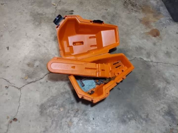

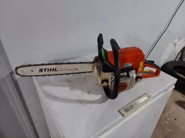

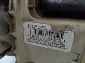

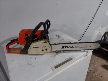

Hi all,
I recently picked up my first Stihl saw off Facebook marketplace.
I got the saw as part of a package deal. $600 for a log splitter, chipper shredder, and the saw. The saw was listed at $75 but he ended up giving it to me for $50 as part of the package.
Anyway, I'm new to Stihl and want to know your thoughts on the MS250. I've done some research and found that this is considered more of a homeowner saw.
I sharpened the chain and added fresh fuel and it started right up and runs perfect. I cut up a tree with it and it works great.
So a lot of what I'm seeing online is people recommending a pro saw. I have a little under half an acre and cut firewood as more of a hobby but do heat the house with the wood (heat pump main source.)
So I don't need a saw to take care of my land. I want one to use for firewood scrounging. Now I've gotten a good deal on a much better saw than my poulan pro.
I want your opinion on whether I should keep this thing around and make it my "forever saw" or try to trade up for a "pro model". I'm happy with how it feels and performs. I also do have a cheap Amazon 62cc 20" Wemars chain saw I can use for cutting up larger trees which I rarely do. Thanks for your input!

Keeper for sure!

The bigest drawback to the 025/MS250 is that they can be hard to pull over for a 45cc saw due to high compression and no compression release. I jacked up my shoulder doing brush clearing with mine, but that required a lot of stops and starts. For firewood it should not be an issue. It's got a good power/weight ratio for a homeowner saw and is durable. Some of them came with .063 chain & bar which can be harder to find chain for than .050. The air filter is pretty small but it works, you just need to clean it more often than a modern pro saw filter.
The quick chain adjuster can be replaced with regular studs and bar nuts. The quick adjust is kind of fiddly to use and needs frequent cleaning to work well. Bar nuts are a lot easier. The model is old enough that the Chinese clone companies make parts, so you can get cheap parts to convert it back to bar nuts if you want.
