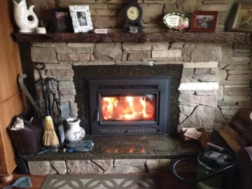

Well i was on the phone with many different dealers that sold many different fireplaces. I think i am down to either to a blaze king princess or a fireplacex hybrid. Dealers that are selling them did not make me feel very confident on burn times and heat output. You can see in the picture my insert, maybe it cost 300 bucks back in the day brand new. How can I convince myself to spend almost 5 grand on a new insert that will not double my heat and time or at least same heat but gotta double if not triple my burn time at the same heat.

Big glass and fits 24" or so splits. It cooks this area when im over!
