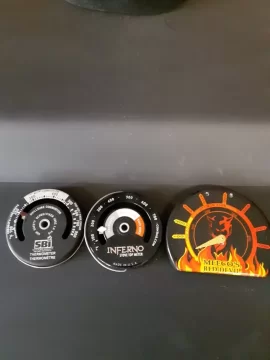

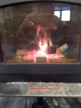

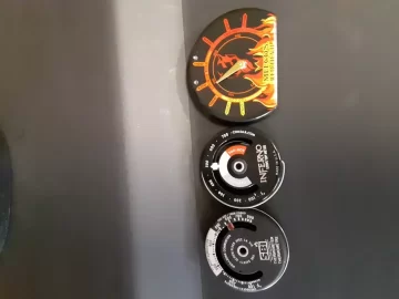

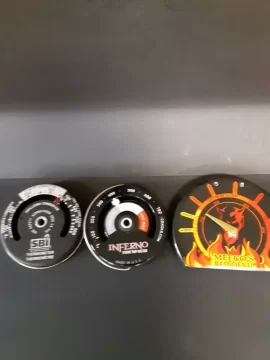

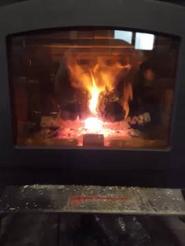

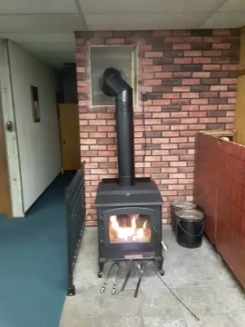

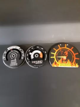

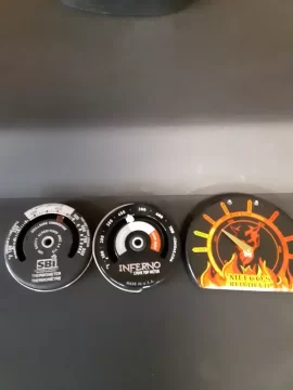

So my Condar Inferno thermometer showed up already today. Ordered it yesterday and was given a Monday expected delivery... must be clean living........... Attaching photos. First is coming back down, then as hot as it got, then as it was coming up, then what it was at to start (warm with good coals). They attached in reverse order of how I took them, sorry if it's confusing.
[Hearth.com] Still the newbie with questions to the experts[Hearth.com] Still the newbie with questions to the experts [Hearth.com] Still the newbie with questions to the experts[Hearth.com] Still the newbie with questions to the experts[Hearth.com] Still the newbie with questions to the experts [Hearth.com] Still the newbie with questions to the experts [Hearth.com] Still the newbie with questions to the experts[Hearth.com] Still the newbie with questions to the experts
This was a small fire. It isn't too cold and I have a lot of small stuff in the pile from branches, so I'm using it up and saving bigger stuff for overnight and when it gets colder. They all change at about the same rate, but very different temperatures.
Last night I tried something I saw in another thread seeing as I struggle on reloads sometimes and think I have my method figured out. Pulled the coals forward, laid 2 big chunks E/W, then filled it N/S (within 2" of the tubes.... a Mad Mark load). I didn't burn the coals down as far as I had been either. Holy hot for a long time! Rec room was still 74 this morning. The stove temp was down to 250 though and a lot of it had turned to charcoal that was out. I had completely shut the air down because it was getting as hot as I've ever had it (690 on the old SBI), the tubes were glowing, and I was ready for bed. So now I found a thread talking about glowing tubes being common and it appears that the SBI might read high, so I may get it going a little earlier and leave it open 1/8. It's still really calm here, so the breeze isn't helping the draft. I threw a few kindling size chunks and some splitting scraps on the charcoal and was good for hours.
Sorry, it appears those photos are in all wonky order... 4th is warm at start,6 & 7 & 8 are coming up, 3 & 5 are peak, 1 & 2 are coming down
I don't see strong secondary in any of the pics, but maybe you just didn't have it at the moments you snapped the pics.
I would trust the Condar, unless you have access to an infrared thermometer gun and can verify. If the Condar proves accurate, you can hold the spindle on the Meeco and move the needle to where it needs to be.
Crappy camera on the phone. There's only a couple of logs in there. The bright yellow in the center is primary flames, the blurry orange above is secondary. When I do a full load, they start out yellow then turn more blue.
I'm only on day 8 with this stove and feel like I'm getting the hang of it. Not smoking the glass much anymore, just a little brown haze that wipes off, getting better fires going faster, not burning the wood up too fast (mostly). I'll say it again, THE HOUSE IS WARM....ALWAYS! No electric baseboards kicking in. I'm actually excited to see the next electric bill to see how much it helps even if it is just half of the billing period.
