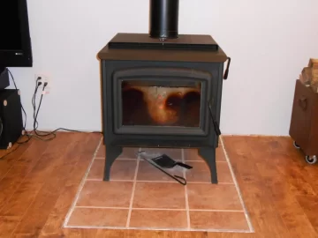

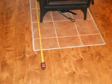

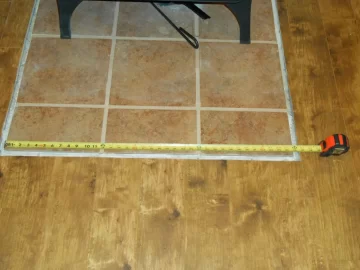

NVHunter, I like the Sirocco 30 just fine. No complaints at all. Still learning to load just a couple splits at lunch so at bedtime I can load it full for the all night burn. My hearth is 36 x 50. The 50" is from the wall to the front edge.

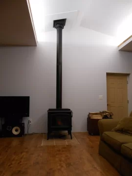

Thanks!!! Looks good. How big of an area are you heating? Your ceilings are about the same height as mine are.
Your measurements are exactly what I was thinking my hearth is going to be depth wise. The width for me is no issue as the stoves gonna be in an alcove.

NVHunter; 2000 sq. ft. It is the big room in the picture (living, dinning, kitchen) and a hallway opposite the stove with three bedrooms & bath. I put a small fan on the far end of the hallway blowing toward the stove and that seems to keep that end of the house warmer.
