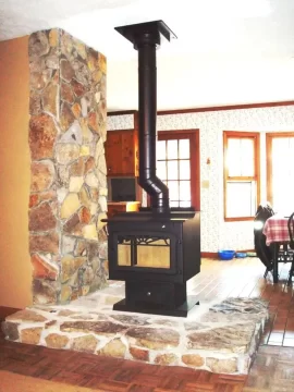

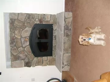

Hi Sambo,
I recently had a Elite 44 installed and installed "cutlured stone" around the unit. I did the cement board then a skim coat over the wire mesh. Turned out strong as nails, you could hang on the cultured stone now and I'm sure it won't come off.

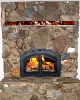

I just installed fieldstone for my new FPX Elite 44 install (see avatar). I was lucky to have a good friend who is experienced at this and he helped me alot. I am a novice but willing to share my experience and what I learned:
Pick a width off the wall that you want to use and work the stones so that the face is within that width plus or minus maybe a 1/2". I used 4". If a stone is smaller pack mortar behind it.
Being a cheap bastard I scrounged all my stone which was a big effort but worth it... plan on getting 2x the amount you will need
look for stones the have straight edges and are of a uniform width (for me 2-4").
Planning the placement of stones is 1/2 the work
Build from the bottom up - 1 row at a time. Working about 2 hr/day it took me 3 weeks to finish.
Try and have the stone be able to sit by itself where you place it.
Consider how the next row will sit on the one you are placing now. Watch our for stones that taper down and away (hard for the next stone to sit on)
Large stones are the eye catchers and they take up space (which you will grow to appreciate).
If you have an arch look for a large center piece stone that has a smaller length bottom than top (more of a wedge shape) - this will help with wieght distribution
We build right on sheet rock and plywood.
We put in "L" angle sheet metal (not sure of proper name) screwed/nailed to beems with the small part of the "L" in the mortar joint to help provide support/safety for keeping the face standing. Might be overkill but easy to do. Set the stone then put this in where the joint will be.
The less mortar joint the better it will look - recess the mortar joint - about 1/2 hour after (again depending on how wet your mortar is) clean out the joint so it is recessed and clean looking
For mortar I mixed mason sand cement to a 3:1 ratio, not to wet....gotta work with it to get a feel for the right balance
Plan your mantel - consider required clearance, how you will attach it, do you want it full length or not. I used a piece of walnut 4" thick, over killed the mounting using angled brackets on top and bottom bolted/screwed into beams and walnut. The stone on top and bottom will also help support it. For mine - I could hang from it.
I apologise, I'm rambling on.... If you want to discuss this feel free to contact me through the PM here. AGAIN, I am a NOVICE but really enjoyed learning/doing this. Real happy with result too!

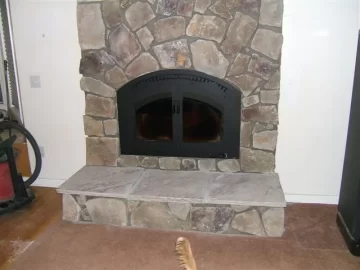

Mike F said:
We just had our fireplace put in about a month ago. We are having trouble with the mortar crumbling between the rock and the fireplace. Did you guys run into that issue?
Mike
Sounds to me like they mixed the mud too wet or used the wrong type. Clean out the loose stuff with a screw driver and wire brush. Get anything that feels loose our is cracked badly. Portland masonry cement mixed 3:1 with sand is usually what I use but they do sell premixed brick mix as someone else already said. Don't mix it wet! The dryer the better for pointing/grouting. Mix it to the consitancy of peanut butter, then let it sit for 15 or 20 minutes. Get a grout bag from your local masonry supply place. Looks like a big cake icing bag. Fill it with the mortar. Then fill your joints back in with the mortar. Give it some time to dry more. When its almost dry but still workable "knock down " your joints and then brush them with a counter brush.
I would agree with everything dvellone said. I would consider using a polymer fortified thin set to adhere the stone if you don't have that much too lay. Then use brick mix to fill the joints. It costs a little more than brick mix but in the end its stronger and easier for someone that's not had experience in laying stone IMO. Use the same method he layed out in his post. Dry stack is a little easier but takes more time.
Sorry for the double post but didn't want to confuse the two jobs.
Mike F - Nice looking install. I like the corner look. What did you use for your hearth top and for your mantel?
I agree w/advice from GKG-MO and likely cause. I also used the 3:1 mix he suggested and keep it on the dry side.
I highly doubt the stone/mortar would be affected by temp change like that. In my FXP 44 when I ran it before closing it in the outside of the box was cool to the touch (other than the front doors). The stone does warm slowly and a little (really not that much at all) but I cant imagine to any degree that would caused movement/shape changes.
I used a polymer-fortified thinset mortar, over loosely nailed wire lath, over dura-rock. Starting from the bottom, trowel it up (thicker consistency is better) and position your preselected stone 1 or 2 rows per day, fill in the gaps using a grout bag filled with thinset mix. The thinset should hold the stones in place until it dries.
