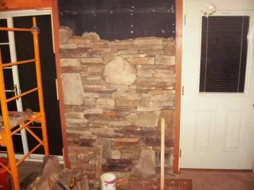

HD or Lowes is not going to be the nicest, or cheapest stone veneer out there. I found natural stone veneer on Facebook market local, which I got for less than 1/2 the cost as a dealer charges. I covered the existing brick. 16' x 7' total cost for the stone was $300.00. Not including mortar & lath, still way cheaper than purchasing stone from a dealer.
I've gotten great deals on Craiglsist also
  • [Hearth.com] Stone veneer or cheaper option?
For me, the fireplace is a major focal point, although I did it more inexpensively, I didn't go cheap on it so to say, with cheap products, just found good deals, as I tend to do. I am very happy with the outcome.

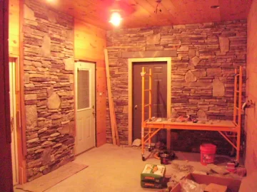

Here are some walls I did in the addition. New office & bedroom. The Fireplace is real stone veneer, the office & bedroom are "cultured stone". Bot install about the same, and both look real & great IMO.

The fireplace stone is 24" x 6" panels made of pcs of real stone adhered together. They interlock to form a seamless look. The Office and bedroom are cultured stone 3 pallets of dry stack ledgestone and 1 pallet of field stone mixed in here & there. The cultured stone takes a bit more time, finding the right pcs to fit together the best, one pc at a time. In 2009 I paid about $2,400.00 for the 4 pallets of cultured stone from local dealer, which at the time was $6.00 per sf for 400sf total.
The fireplace real stone I found on Facebook market locally for $300.00 for about 125 sf, of which I actually used about 112 sf. I have about 3 or 4 panels left over, which I will be cutting down to fill in between the hearth slab & slate hearth extension. At dealer the real stone panels run about $5.95 -$6.95 sf depending on color. Lots of work,& tedious, but well worth it in my opinion. Not a brick fan at all.
Reactions: SpaceBus
Wow, that looks great! The cultured stone is identical to my eye. Those are the colors we are thinking about, but haven't found local dealers yet.
