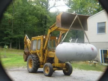

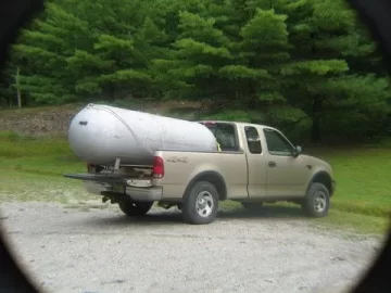

Well, against my better judgement I picked up a 500 gallon Storage/Propane tank. The price was right. Especially compared to what is out there on the market.

You gonna mount it up or down ? How about tapping's ? Installed inside house or out in shed ? Your truck looks like it handled the weight alright. Guess it helps to have a loader around.
