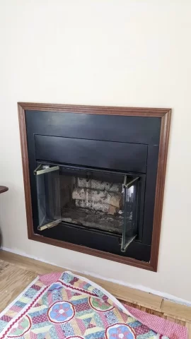

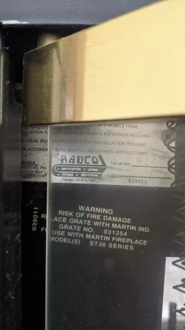

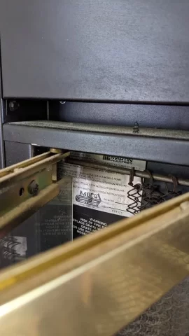

This may take thinking outside of the box. It would be good to determine specifically what the double-sided fireplace is. Often these are more of a liability and heat losers. If it's a prefab then it might be worth thinking about removing it entirely and installing a new flue for a freestanding stove. Then place the stove facing the living room.
A picture or two and a sketch of the floorplan may be helpful.

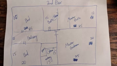

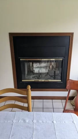

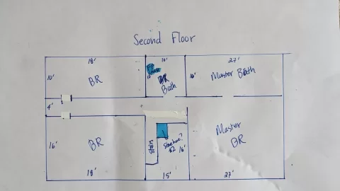

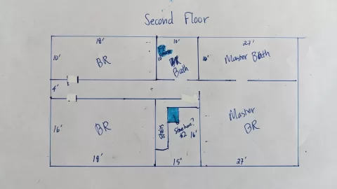

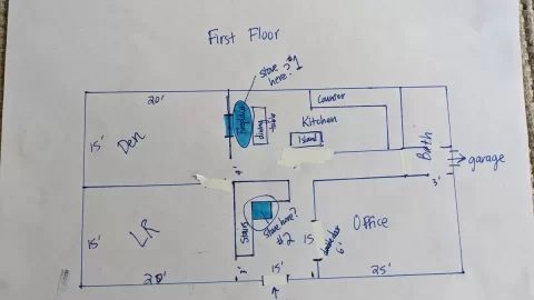

Here are pics of a rough floorplan and the 'fireplace'.

The fireplace isn't in a bad spot for a stove. How wide are the doorways to the rooms? If you were to run a chimney straight up through the bathroom, what would be in the way? Or is there a chase for the fireplace chimney already existing?
3600 sq ft is a lot to ask from a single stove.

This style layout is not the best for easy heating due to the closed off rooms. Fan assistance can help.
Does the LR have an opening to the entryway? Is that a possible location for a stove with a new chimney potentially running up thru the upstairs hallway (boxed in)?

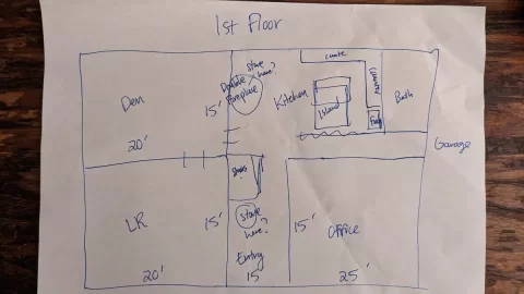

I'm sorry for the poor and confusing layout drawing. Here is one that is more accurate and precise with door openings and scale.
There is already a chase. From the installers I've spoken to it looks like I'd need a liner if going that route.
Part of the stove choice question is looking for actual experience as everyone uses different numbers for sq footage covered, BTUS, etc. IS a bigger firebox going to make a difference if I'm here to load? I assume there are also pros and cons to soapstone vs steel vs cast iron and the different types of heat? I'm totally open. If a BK, what are the pros? Why? I don't mind a steel look. Thanks! PXL_20230907_120418977.jpg

The hallway location is not great, for all the reasons you have already noted. Before deciding on the stove the location needs to be figured out. The odds are that an insert can not be put in the fireplace, but that should be checked. It would simplify things. Otherwise, what is being proposed? Removing the fireplace and creating an alcove? Stoves have specific alcove requirements that need to be followed. Usually in that case the chimney is removed too and replaced with class A chimney and the stove connects at the alcove ceiling. Search on alcove install for examples of this type of install.

I've come around to the location being the fireplace in the kitchen. The one installer who came out to see it thought there could just be a liner installed and then plate off the other side of the fireplace. Also add some kind of air draft support with fins to diffuse the heat coming off the pipe?
I spoke to an installer last night who thought we could just do a liner too.
An important detail is that I'm planning that the stove sticks out a bit into the room, venting out the back into a T, then up the chimney. The stove taking up the entire dining area, and moving the dining area into the Den, was the major hesitation, but it seems to make the most sense for heating.
Does that change your thoughts?
The stove, and hearth, would stick out and that space would be dedicated to the stove, wood, etc. We also have a small child and we'll need to gate it off. The wood stove would be 10 feet from the cook stove, island, etc. Other clearances should be fine but I will double check,
That defines a rear-vent stove which narrows the field considerably. Why couldn't this be done on the den side?
That sounds pretty bogus. I am skeptical about this idea.

I'm fine with it being on the Den side, but thought it would keep the heat more contained in the den which is on the end of the house rather than in a more main and open space for the warmth to flow.

The layout is going to need fan assist for more even heat distribution regardless of location. This is a typical issue with colonials. There are some past threads discussing moving the heat in a colonial layout.
For more even heat in the house option one would be to put a table or box fan at the LR opening, placed on the floor, pointing toward the Den. Run it on low speed. It will blow the cooler air down low, toward the woodstove. The denser cool air will be replaced with lighter warm air from the stove room. Running this way it will pull hot air through the kitchen and hallway to replace the air blowing into the den. It will also keep the den temp moderate. If there is a basement, then this could be ducted with a quiet inline blower for a hidden circulation system.

I’d put the stove where the family will be. If that’s the kitchen, put it in the kitchen. If it’s the den, put it there. Stoves are space heaters and will most reliably heat the area they’re in.
