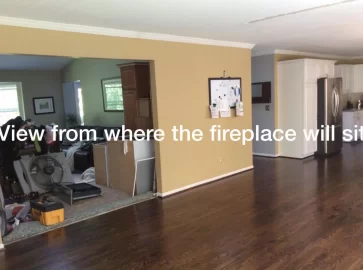

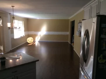

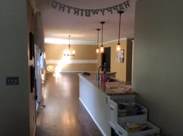

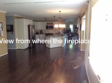

In order to tell how it might work we need more info. How large is the area where the stove will be? How open is it to the other rooms on that floor? Is there an open stairway nearby? And last, how tall are the ceilings in the stove room?
[Hearth.com] Stove big enough but won't be too hot [Hearth.com] Stove big enough but won't be too hot [Hearth.com] Stove big enough but won't be too hot [Hearth.com] Stove big enough but won't be too hot
I have four photos, the first two have a smiley face where the stove will go (just got floors finished and still under construction). The second two are the view from where the stove will sit. There will be a seating area, love seat and chair, around the stove.
The room is about 18 ft wide, 8 ft ceiling, and as you can see it's pretty open. I want to heat as much of the house as possible, but not at the cost of making the seating area too hot to sit in by the stove.
Thoughts?
With this large open area it doesn't look like overheating the room will be an issue. For your cold climate I would lean toward a 2.5 to 3.0 cu ft stove.
