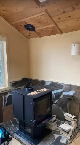

So I'm trying to figure out how close to the wall I can put my stove.
Manufacturers manual only shows distance to combustibles, but what is my hearth is also included on the walls and above the stove (see picture), Do I still need to follow manufacturers clearance or I can put the stove closer to the wall? I realize I'll need to use double wall stove pipe in order to meet clearance requirement to walls that are not protected.
