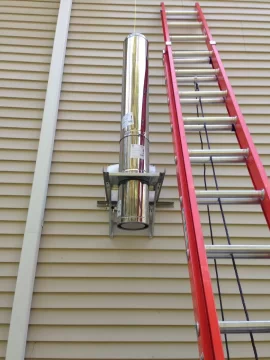

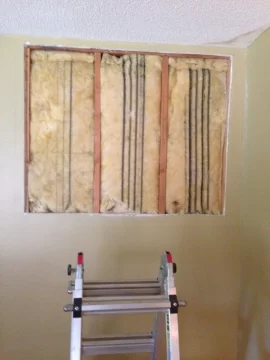

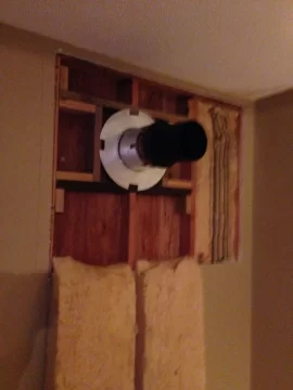

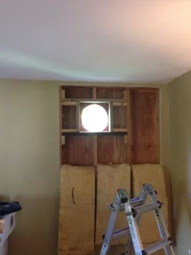

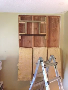

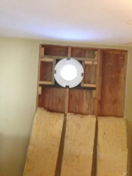

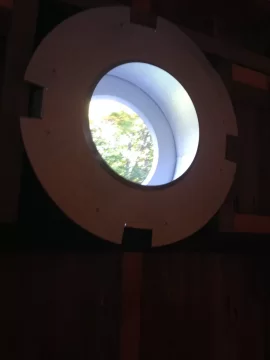

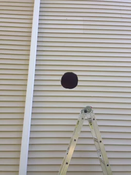

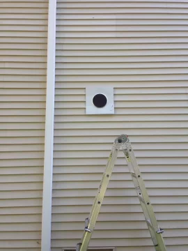

I am new to the forum and have been leveraging the collective knowledge here to install my first wood stove. I just purchased a new Quadrafire Explorer II and I am doing a corner, through wall install. I am a little confused on one of the specs listed in the install manual for this stove.
The install manual stats that if it is a through wall install and you are using a 90 degree elbow, there should be 26.25 inches between the ceiling and the stove pipe. When I put the thimble in, I used the double wall stove pipe clearances and exceeded those at 12 inches. In addition, I am using two 45 degree elbows for the connection instead of a 90 degree.
My question is this. Since I am using double wall stove pipe and the clearances there are at least 6", do any of you anticipate this being a problem? I am including some pics of the install so far.

Horiz double-wall needs to be at least 8" from the ceiling. 6" is the wall clearance. The manual appears to have a printing error. I would contact Quadrafire and ask for a written clarification for inspection purposes. It looks like the Cumberland Gap has it right for double-wall. It list H as 8", but then they screwed up with the single-wall giving it a listing of 10.5 which is way too close. Quadrafire needs a serious proof-reading of their clearances documentation.

How much clearance will there be above the double-wall connector to the ceiling in your installation?
That is well within the pipe specified safety range. You should be good to go.

Maybe then you could put a real header in there where you cut that stud.
Passed inspection today. The inspector stated today that he uses the stove clearances for the stove and hearth and the specs from the pipe manufacturer for the clearances from the pipe. Anyway the stove install is complete and passed both the insurance inspection as well as the building inspection. Even without a real header ;)
