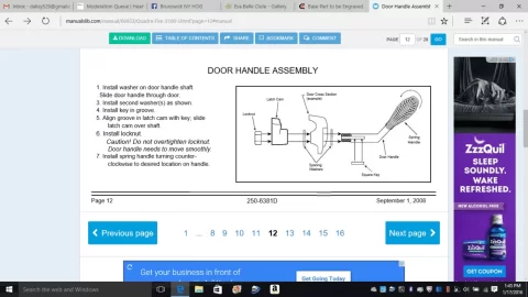

Is this your handle assembly?
Is it assembled correctly?
You should be able to remove one washer (or more) to
get the door to tighten against the stove face

I have the fiber handle shown below. Door is hot now but I can only see one washer. The assembly shows three washers. Is it common to have to adjust the handle after less than 48 hours of burning?

Thanks Bob. I guess the dollar bill test is the real deal. I'm going to let the fire burn down, dis-assemble the handle and remove a washer. I'll report back. I don't think there is anything else causing my fire to burn that hot when shut down.
