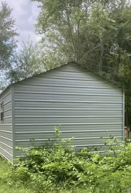

Here’s my cabin my stove is going into.
it’s basically a galvanized shell at the moment.

That's a bit of a jump from "a very good quality one so it can burn all night", but it will probably suffice in most of TX winter weather.
It's a small stove with about a 3-4 hr burntime, so bring an electric blanket to avoid 3am wakeups to feed the stove.
manufacturer says 8 hrs burn time.
It has a 1.7 cubic foot box.
I hope if I load it at 900PM that it will still have the house warm at 400AM
I normally wake up between 4 and 5
Maybe I am mistaken and thinking of a different model. The 1200 sq ft model is WS-2417 which is about 1.3 cu ft. Is your stove the larger, medium-sized WSL1800?
