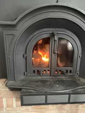

When I bought our home. The glass panels in the doors of the stove were covered in creosote (you could not see the burning flame at all). I bought some creosote glass cleaner and got close to 90% of the creosote off the glass. Figured it would solve the issue. But after two burns the glass is covered in creosote again and once again can’t see through the glass. Is this a glass issue? Would I need to replace the glass? Or does someone have any insight onto why the glass is getting a buildup.(I do run the stove at a plenty hot temp). Thanks. Any input would be appreciated.

The wood I’m burning is dry and I’m running the stove at around 600 surface temp. After I cleaned it. It turned black almost immediately after the fire started. On the first burn. By the second burn you couldn’t see through the glass at all.

I don’t damp the stove down much till I get a good bed of coals going. I’m running the stove plenty hot. I run the stove between 600-700 surface temp on the stove.

It’s a Quaker Moravian stove
Lousy airwash if there is any at all. Windows on these old stoves like the Defiant etc. were almost useless.

It can be one of two things:
1. Lack of properly dried wood.
2. Most likely a stove design issue, especially if wood is below 18% moisture.

You should post a picture of the stove so we know what model it is.
They made the arched top Moravian in an Insert, freestanding parlor and hybrid. (the hybrid has a round secondary intake at the top, front and center. Keep that closed for wood)
If it has grates (like flat plates on the bottom and a shaker handle on the right side) and a ash pan, it gets air through the ash pan door and is a hybrid wood/coal stove. They don't have the air wash the wood models have. Some models have a tag on the back with model number. They say wood, or wood/coal.
The wood stove models have slots through the doors under the glass windows. Is that the only air intake on your stove? Or are the air openings on the face plate below the doors?
Make sure there are no leaks into the stove. You want ALL incoming air to go through the air wash. Any leaks, like door gaskets or cracked cement in joints is air that balances the air pressure in the stove, taking away from what needs to rush into the intake at glass.
You don't have a fan blowing on the stove or across the front do you? Air movement over the glass can cool it causing problems.

I usually run the air wide open till it gets going real hot. Then I close the air intake and dampen it down about half way. I’m not expecting the glass to stay super clear.(it’s dark top to bottom) But I would at least like to be able to see into the stove while it’s burning. I may just have wet wood like a lot of people are saying. I tested for moisture and most of my ash was reading around 18% moisture. I will have to see next season if the glass gets this way again after my wood seasons another year.

That is a wood burning Fireplace Insert, not stove.
That changes what is needed to work properly and be safe.
Did you check to see how it's vented?
Make sure this is connected to a liner the same size as the Insert outlet.
That is code and needs to be directly connected to the liner from Insert all the way up.
The safety reason is due to allowing exhaust gases to expand in a larger chimney flue that was existing for the fireplace. This allows them to cool below the critical 250* f. temp wetting the flue walls and allowing smoke particles to stick. This forms creosote. At one time you could do that, but time has proven they do not stay hot enough due to cooling of the exhaust gases.
Another reason is if the chimney does not comply with all current building requirements it needs an insulated liner. Indoor chimneys require 2 inches clearance to framing and exterior chimneys require 1 inch to combustible framing materials. Most do not comply and require an insulated liner.
The third reason is as I stated above, ALL air must go through the air wash intake. This is to get the correct flow across glass. It is difficult to seal an Insert to the face of a fireplace to prevent air leakage into the flue. This takes away from the air needed to go into the air intake across glass. Atmospheric air pressure will PUSH into any opening it can to get into the low pressure area caused by the chimney. That's what makes a stove go, and you want it all going through the air wash intake to keep smoke away from glass.
So if you never pulled the faceplate to check above the Insert, or don't know if there is a liner, check that first.

There is a brand new liner that was installed before the owners sold the house. All paper work was provided. It was done by a reputable installer. So I’m not too concerned with the installation of the liner. But I may pull the faceplate and check to make sure everything was installed properly. Thanks for the advice!
Good, the Insert was made to just slide into hearth and use the existing chimney, so they all don't have an easy way to connect the liner. That was done with a boot attached to the top of Insert that connects to the liner. Make sure however they attached it, that it has a gasket or is sealed to the insert top.
